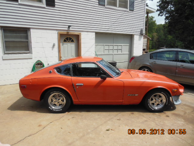

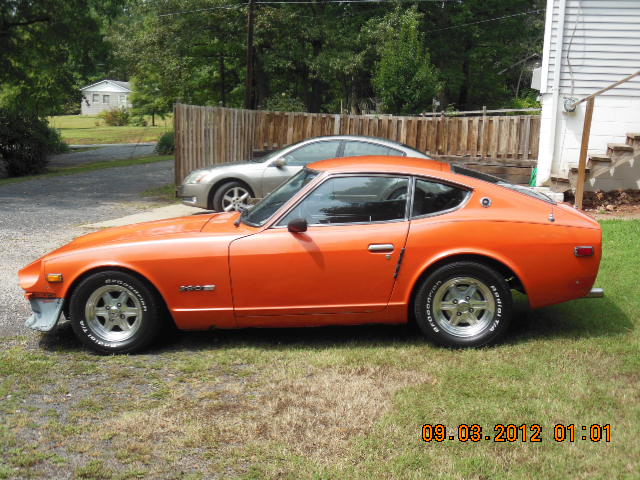

hi my name is wallace a friend of mine has a 1977 280z .do they come with voltage regulator,i've searched all around fire wall but nothing.i'm pretty sure it's build in alternator . If any-one has a 1977 or can point me in right direction .THANKS
