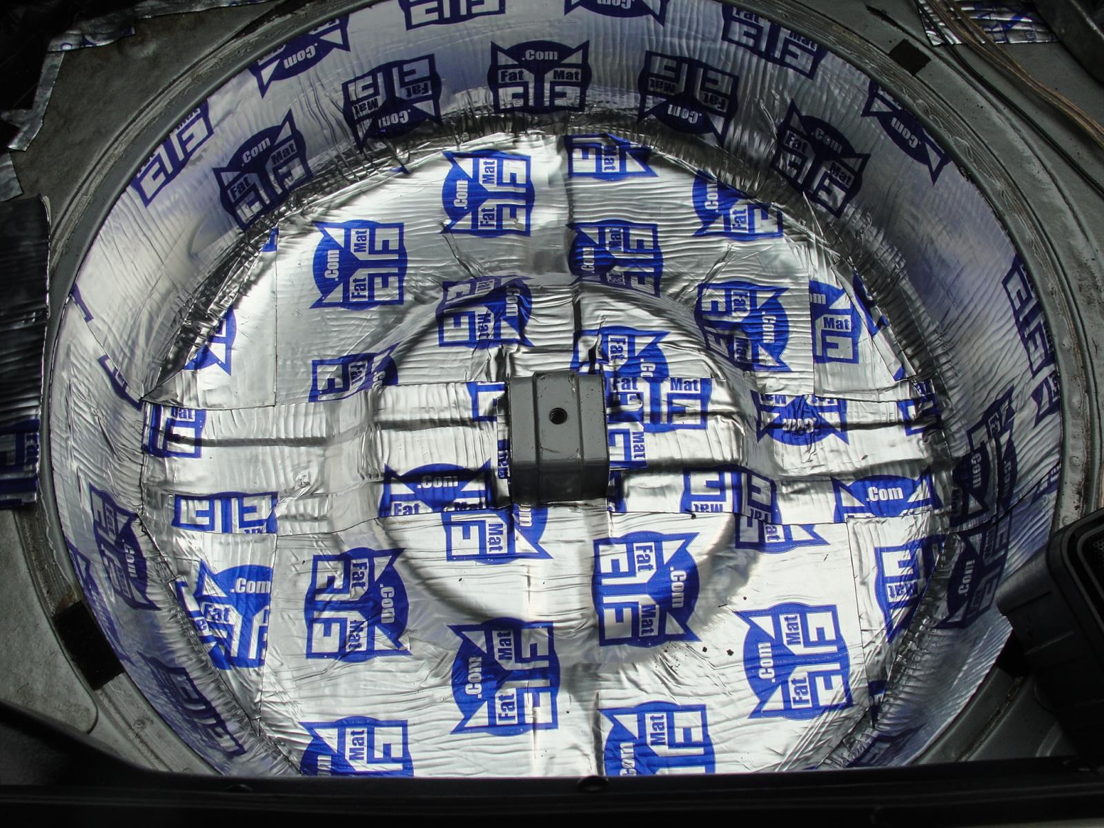

Hello, I just finished the sound deadening on my 73 240z and wow what a difference, these cars are famous for road noise and other raddles and thing like that, I also replaced the weather stripping and door bumpers, It's lots of tedious work but well worth it. I used Fatmat it's easy to work with and less money than Dynamat. Not to mention the stereo sounds great.
Here's a few picks
Tom
Attached Thumbnails sound deadening-fat-mat-002.jpg   sound deadening-fat-mat-001.jpg   sound deadening-fatmat-008.jpg   sound deadening-fatmat-006.jpg

How much did you spend?
Does it install fairly easy? glued?

Hello, It was just under $200.00 I used Fatmat Raddle trap 80 mil on the floor and 50 mil on the rest of the car, it has a foil back that peels off then you just stick it down no glue needed its very pliable. I got it through Amazon. I really works!
Tom
