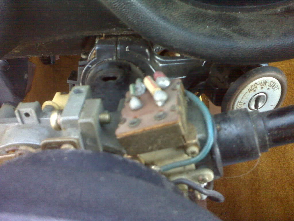

Ok a bit OT but I need to figure it out, ATM none of my dash lights work at all and my tail lights dont light up at all, Headlights, turn signals, side marker lights all still work. No bad fuses I already checked.
Somewhere I read that the problem lies in the dimmer switch. Does any one know?
Also I searched, but only came up with 280ZX and Z31s with the same problem
Ok shouldn't all 4 wires on the top of that box have power to them when the light are all on?
Off- 1 Wire with power
On first- Same wire with power, no others
2nd Click- Red wire has power along with the first one.
Im thinking that means the switch is bad... Or am I missing something? Please help I want to get this thing Inspected here soon so I can drive it around before winter hits
