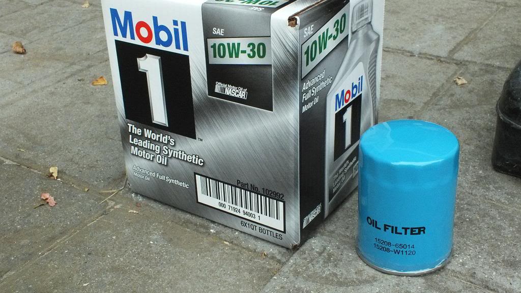

SlicktopS130 Jun 17, 2014 09:43 PM
4 Attachment(s)
Changed the oil, gave the engine a full tune-up and replaced the totally rotten radiator.

Just so all of you know, the Z motor requires zinc in the oil for proper cam lubrication. They stopped putting it in motor oil because of emissions. Mobil One is great oil but does not have it. The only way is to add zinc available at auto supply. Valvoline Racing Oil has it and now Royal Purple has a new oil with it.
The new synthetics seem to leak around the old seals, my '70 leaked really bad with it.

lumens Jul 2, 2014 09:57 PM
You will need to pull that head and take it to a machine shop.
Have it checked to see if it is badly warped. If so you can pick up
used heads for $150. Also I would not waste money on synthetic
oils on an old motor. The quality of motor oil is so much better than
it was in the 70's. Modern zinc content is not a problem with these
motors. The big concern is for the old flat tappet cam push rod motors.
I would be concerned the engine is just as full of sludge as the cooling
system. Use an oil with the very highest detergent content.

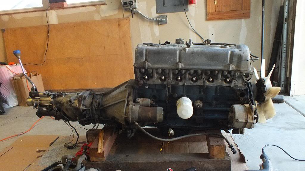

Based upon all of the given factors of this engine, I decided just to get an entire whole new engine. I mean i could have gone through the steps to rebuild it, but who knows. Corrision would have probably eaten its way through the cylinder walls by then or worse (if possible).
This is what i bought.
Attachment 15616
It's an L28E, F54 block N47 head 9.7:1 Compression. Not sure if head is from a maxima or not, but there is a spray bar on the cam. Mileage is unknown, engine came out of a '75 280Z with 88K, but this is a mismatched engine so who knows. Came with a 4 SPD tranny which i will be selling.

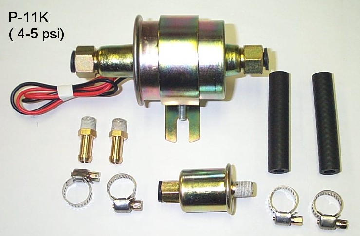

Yeah. I half expected something to go wrong anyways. I liked that L24, lots of high end power. Not sure how high i can safely rev this L28... Hopefully to 6K. I'm definately going to do some engine bay cosmetic work. Not sure if ill go polish, but maybe a flat red with the letters and trim white, paired with yellow plug wires. I think that'll look cool. :icon_super:
Due to this engine not having that vacuum port on the head for the stock pump, i am going to have to go electric.
Attachment 15615
This is what i bought. AND YES, THE MYTH HAS BEEN CONFIRMED! :033: Nissan had installed factory accessory wiring to accomodate for something like this. In the radio compartment, taped to the major harness there is a T plug with two wires, GRN and BLK with a white stripe. Connect those two together (Preferable with a fuse in between) and you'll get power to wires by the tank that are also taped up, but to the fuel sender harness. Connect those wires to the electric pump. What all of this does is enable the pump to work automatically once the ignition is turned on. :040: Now i just gotta figure out which fuel hose is the main hose to the carbs...

lumens Jul 6, 2014 11:04 PM
Quote:
http://i1270.photobucket.com/albums/...pscdb49ad7.jpg
The 75 280Z came with the N42 block and N42 head. Definitely from a
later model. A F54 block would designate from a 81 to 83 280ZX.
Agree. A complete different motor sounds like an easier way to go.
