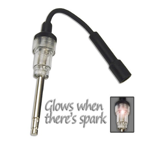

Actually, unless you're leaving out details, you don't know that cylinders 3 & 4 aren't firing.
Have you used a tool like
this this
(see picture below) to see if you have a spark on those cylinders?
Have you verified the injectors on those two cylinders are closing and not flooding the cylinder? You mentioned the plug are wet.
Have you done a compression check on the cylinders in question? (This isn't really related to the cylinders not firing, but it does relate to your question on valve clearance.)

Thanks for replying! I did some tests yesterday to verify that the cylinders are misfiring. First thing I did was take a timing light to the wires of each plug and they all fired fine. I replaced the two plugs, and that did nothing. I noticed this morning that it was running fine when I started it up and it idled cold great, but after a few minutes of driving it it developed that misfire again. So the misfire only happens when the car is warm or under load.... I did the compression check a couple weeks back and they were all good, I think they were in the 150ish range. The spark plugs are wet, but I wouldn't consider them so wet that maybe the injectors aren't closing. I can feel the clicks from the injectors opening and closing, and they are all brand new. Anyway, again thanks for the input!
