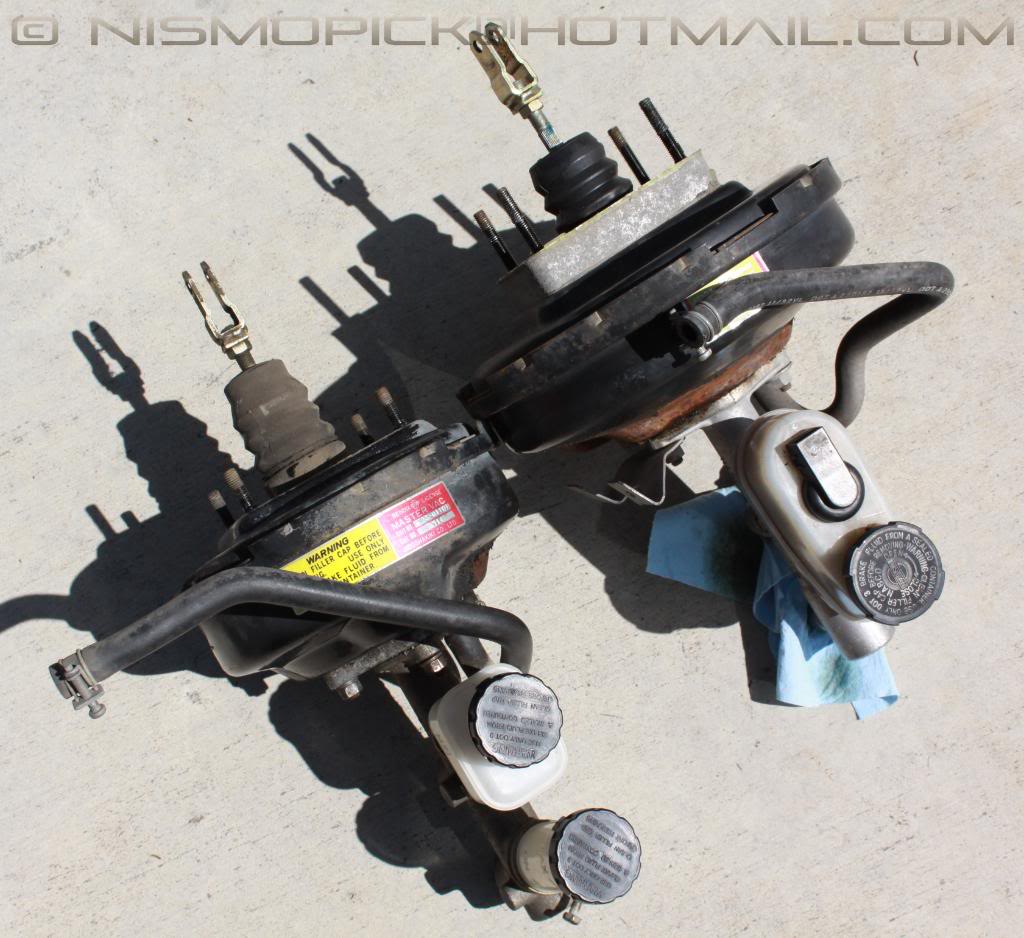

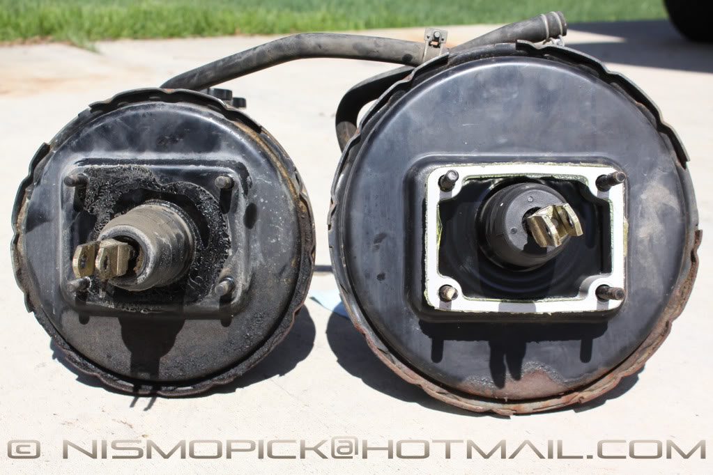

5 Attachment(s)
Installed an 82 280ZX Turbo brake booster & master into the 76...
Booster must be clocked 180 degrees for the push rod to fit through the firewall, and the pedal link has to be adjusted out, and even at the very last few threads, the brake pedal is now sunk in more than the clutch.... except I'm now thinking that if I take off the spacer / adapter on the back of the 280zx booster, it would have more adjusting room.
Good thing I didn't fill the system yet. I'm going to take it back apart on Monday & see if I can get a more exact fit w/o the spacer.
